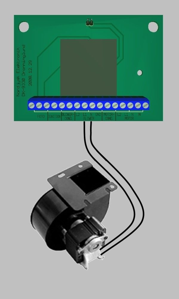

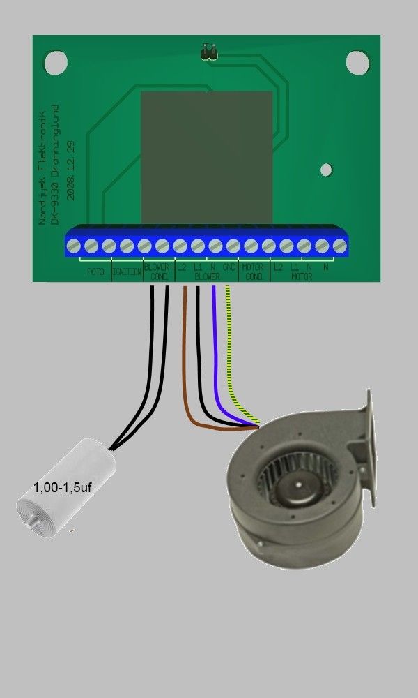

Hi to all.
Which blower can be fitted to the Woody-16 instead of corrupted internal Rebeck97?
What of the variants below is better ether http://www.hedestoker.dk/content/Scotte-pillebr%C3%A6nder/Blaser3.jpg or http://www.hedestoker.dk/content/Scotte-pillebr%C3%A6nder/Blaser1.jpg?

« Svar #1 Dato: Sep 05, 2013, 13:21 »
They can both be used.
The two-wire, no need capacitor.
If you change the type, you should be aware that they have different holes.

« Svar #2 Dato: Sep 05, 2013, 13:33 »
Thank you Michael.
ok. But where we can find original Rebeck97?
The two-wire, no need capacitor....
any other pros / cons?

« Svar #8 Dato: Sep 05, 2013, 14:30 »
http://www.hedestoker.dk/3628_blaeser_til_scotte_10_20_kw.html
but what about the problems described  by Michael above (mismatch of the mounting holes)?

« Svar #10 Dato: Sep 05, 2013, 16:05 »
http://www.hedestoker.dk/3991_bagplade_for_pillebraender_10_20_og_30_kw.html
I'm quite sure that needs to be cut and welded into the burner.... so that's not a good option.

« Svar #11 Dato: Sep 05, 2013, 16:06 »
thank you very much Michael.
But vast difference in the price! 3 times cheaper?
Yea, there's a reason why they changed to this new shaded pole fan... it is quite allot cheaper, but unfortunatly it's also a little smaller, so it doesn't mount on the older burners without some modification... but it is possible if you are a little handy.
Sv: replacement of the fan
« Svar #12 Dato: Sep 05, 2013, 16:47 »
I know NBE has developed an adapter plate so you do not have to change the entire rear section.
Ask di dealer about it.
